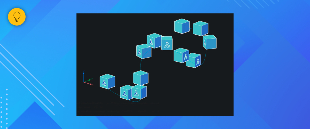

Arrays in BricsCAD
Did you know, there are 3 types of Array in BricsCAD. In this post we look at what arrays are, how they work, why you should use them and how to edit them.
What is an Array?
Simply put: an array is just an arrangement of entities (objects) that are repetitively space in a rectangular or circular shape, or arranged along a path. Arrays are super useful for creating copies at set intervals. They work in both 2D and 3D.
In BricsCAD there are 3 types of Array:
  • Array Rectangle
  • Array Polar
  • Array Path
