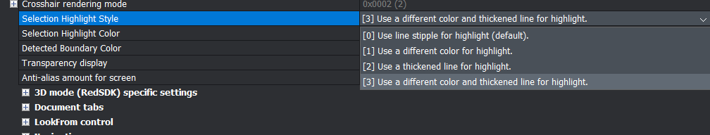

4 Change the way the entity highlights on hover
If you have trouble seeing your cursor when you hover over an entity or trouble seeing which part of an entity is selected during a hover, you can change the way the entity looks when you hover the cursor over the entity.
Simply enter Settings and choose between stippled line (default), different color, thickened line and color, and thickness.
