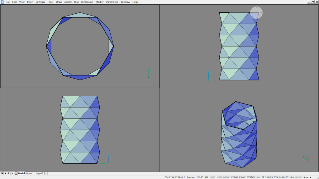

Section view of a surface model. There is no data for the internal mass of the object.

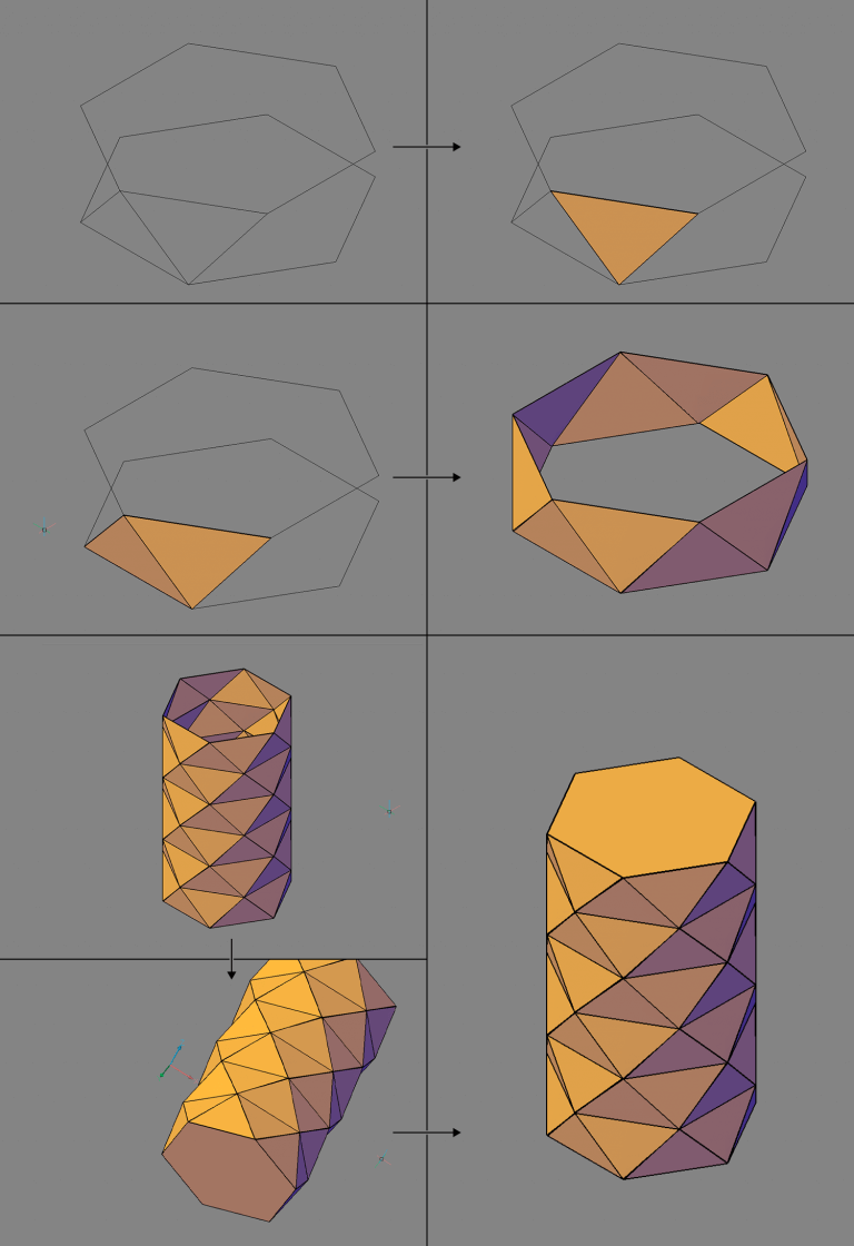

In this example we will create a triangulated tube (as illustrated above).
  1. Mark out your linework.
  2. LOFT between two lines to create a surface.
  3. Repeat.
  4. ARRAY, COPY, ROTATE, and COPY again to finish your tube.
  5. Use REGION to cap the tube.
  6. Repeat for the other end.

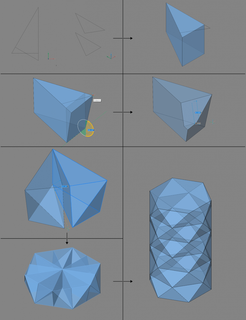

To create the same object as above:
  1. Create your linework.
  2. Extrude the triangle.
  3. Rotate the face with the Manipulator tool.
  4. EXTRUDE the boundary.
  5. Use MIRROR and ARRAY to complete the shape.
  6. Finally, execute UNION to join the solids.

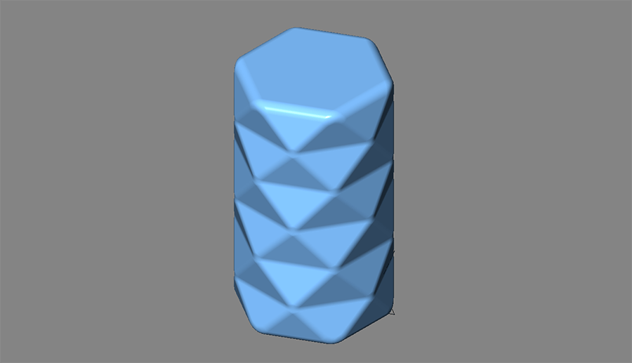

Unlike the surface model, I can now edit this solid with the Direct Modeling (DM) tools, such as DMFILLET and DMPUSHPULL.
Tuesday Tips - Solids, Surfaces, and Meshes- fillet
In this example, I have used the fillet command to curve the edges and soften the shape.

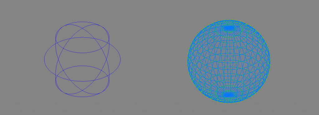

Left: A sphere as a solid in BricsCAD. Right: The same object converted to a mesh. the green dots indicate control points

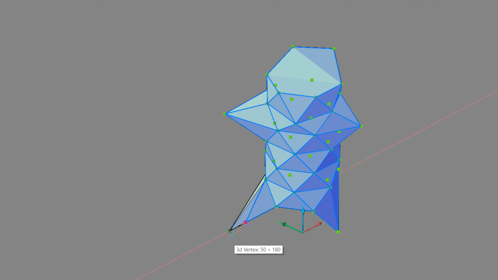

If we go back to our earlier model it means I can now do things like this:
Tuesday Tips - Solids, Surfaces, and Meshes- polymesh tube-1024x575
Solid has been converted into a mesh and can now be manipulated by points.
