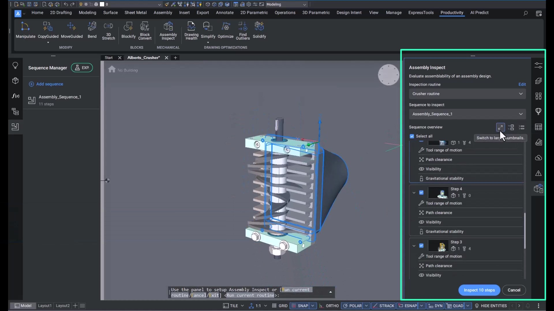

In this example, you can see the Assembly Inspect Tool in BricsCAD Mechanical applied to a crusher assembly. Use the BMASSEMBLYINSPECT command to open the tool. You can specify an assembly sequence you want to inspect, and review the sequence quickly using the respective thumbnails and “eye” icons.
The applicable assembly criteria are shown for every step, and are specified in the routine.
Evaluate assembly criteria
You can evaluate all the criteria for every step in a single batch, or if you want to take a more granular approach, you can use the “Inspect” button next to each criterion and step.
Once the Assembly Inspect Tool has completed its calculation, it shows you any potential assembly issues. Then, you can delve into the details to understand where the issue is, and how to fix it.
