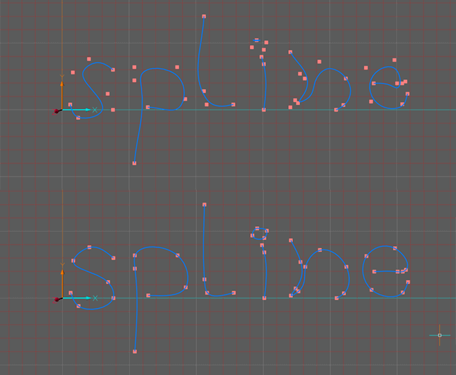

A spline is an open or closed, smooth curve defined by a set of points. Splines can also be created in 3D. A spline is created with a fit tolerance on the insertion points.
Splines, Polylines and 3D Polylines- splines acuracy
Top: Spline with a high numeric fit tolerance. Bottom: Spline with 0 fit tolerance
Once you have created the line, use the Properties panel, fit tolerance option to change the tolerance. The lower the number the more accurately the line crosses the insertion points. You can also use the Properties panel to control the spline with vertices instead of fit points.

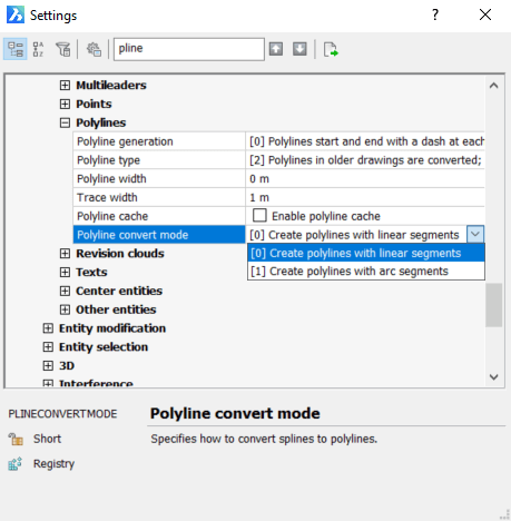

Splines can be really great, but sometimes, you'll want to convert them into polylines. Use Splines, Polylines and 3D Polylines- 01 03 Pedit Button PE (EDITPLINE/PEDIT) to convert to a polyline. Enter the command and then select a spline. The command line will ask: The selected entity is not a polyline. Turn it into one?... Choose YES and hit Enter. You will then be asked to specify a precision, the lower the number, the simpler the result. Under Settings -- PlineConvertMode, you can choose to convert to straight lines -- 0 or lines and arcs -- 1.
Splines, Polylines and 3D Polylines- ployline seetings
Note: PLINECONVERTMODE must be switched on -- 1.

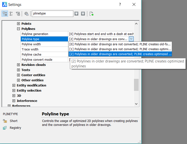

Older .dwg files traditionally stored 2D polylines as "heavy polylines", which was larger in file size. Modern .dwg files store 2D polylines as "light polylines" (without z-axis information). Use PLINETYPE to automatically create polylines as either "heavy" or "light" polylines. It also allows you to dictate if older polylines are converted to light ones when loading a drawing.
Splines, Polylines and 3D Polylines- ployline settings 2

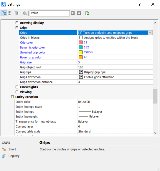

Polylines are controlled by grips. Settings -- Grips determines how many grips are displayed. 0 -- no grips, 1 -- endpoint grips only, 2 -- end and midpoint grips. Grip size and color is also completely customizable.

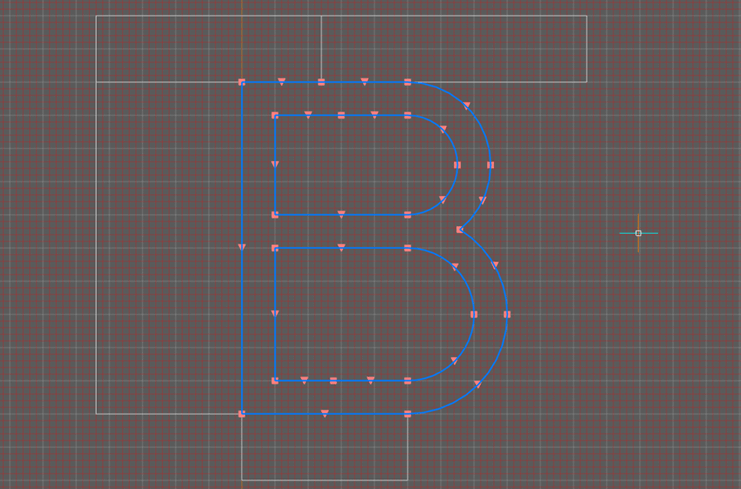

Vertex editing -- This is really powerful. The vertex selected is indicated with a small white cross. You can use the options to break a polyline up at a selected point, straighten or bend a line segment, and even, change the width of the line segments individually.

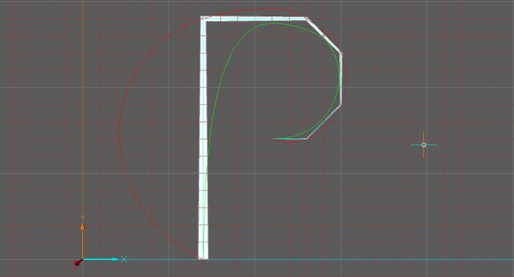

Fit -- Convert straight line(s) to curves. This can be useful if you want to quickly draft an object with straight lines and then convert to arcs.
Splines, Polylines and 3D Polylines- p all
Red: Fit, Green: Spline, White: Taper, Blue: original polyline.

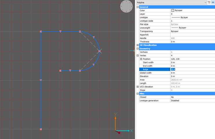

You can also use the properties panel to convert individual polyline segments into arcs. Under Geometry you'll find options to convert to and from curves. Vertex indicates the vertex selected. Again, a small white cross is displayed to indicate this. Use the dropdown menu to navigate the selected vertex.
Splines, Polylines and 3D Polylines- properties curve

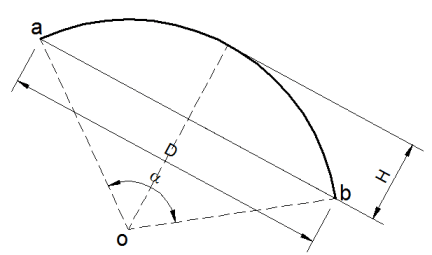

The Bulge option is used to change the curvature of the line, straight line -- 0, perfect half circle -- 1. The radius continues increasing well beyond this. Positive numbers create counterclockwise curves and negative numbers, clockwise curves.
Splines, Polylines and 3D Polylines- 07 Bulge Scheme
The start and end width boxes change the width of the line on that segment only.
