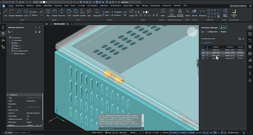

Evaluate the interaction between different sets of objects
interference manager
Managing multiple parts in a single assembly is easy with a detailed breakdown from the Interference Checking feature. This feature is a powerful tool designed to enhance your workflow and provides a comprehensive overview so you know that each element is accounted for in your design process.
colour breakdown interference
It calculates interference volumes, which delivers a precise assessment of spatial conflicts and presents the results clearly. It lists block and solid names as they appear in the Mechanical Browser and uses a three-color code system to highlight interference areas.
real-time change
If you make an adjustment, the system updates, reflecting real-time changes. This immediate feedback loop helps you to iterate quicker and continuously improve your design.
door closed resolved
In this example, you can see that we successfully resolved the interferences around the hinges in the door-closed configuration. Now, let's see how they interact when the door is open.
door open interference
The results show that the hinge in the door-open configuration interferes with several parts. In this case, moving the hinges will not solve the interference, suggesting that a redesign may be necessary.
redesign cabinet
So, we redesigned the cabinet with external hinges and fasteners. When we recheck it, we can see that the external hinges do not interfere with the cabinet with the door open.
