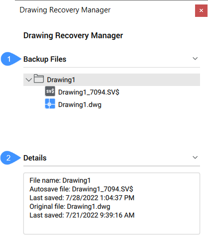

How to recover files in BricsCAD's Drawing Recovery Manager?
In the Drawing Recovery Manager panel, you can see a list of all drawing files that were open at the time of the crash. Backup files are displayed as a list of folders containing the drawing files that can be recovered. For each drawing, you choose from the following file types, if they exist:
DrawingFileName_recover.dwg
DrawingFileName_a_b_nnnn.sv$
DrawingFileName.dwg
DrawingFileName.bak
BricsCAD Drawing recovery manager panel
Additionally, the panel displays a few details for the selected file, such as the name, location, and size of the file and the time it was last saved.

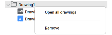

You can right-click on any item in the list to access different actions depending on the selected item.
  1. Open all drawings from a specific folder or remove a folder from the panel without recovering the files.
    BricsCAD Drawing recovery folder view

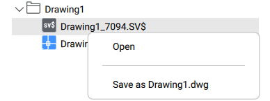

  3. Open .sv$ files, you can choose to open it or save it as a .dwg file.
    BricsCAD Drawing Recovery svs view
