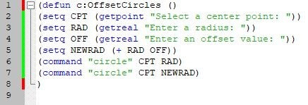

We almost have a working program. We need to group these lines of code together as "one unit". The (defun) function does just that.
(defun list symbol expression expression expression...)
This function creates a user defined function that can be used just as the "built-in" functions or as a command. It requires at least three arguments.
  1. A list. This list can be empty. We will use an empty list until we are ready to discuss this more deeply, later.
  2. The function name we want to define. If the function name starts with "c:", the function name can be typed in directly at the prompt as any other defined command.
  3. Remaining arguments -- the expressions that you would like the defined function to perform.
Add the following code in the editor:
How To Draw Using LISP - The Black LISP -02- 3.2
Note: If the colors in the graphic do not match your screen you may have forgotten to delete and retype the quotation marks.

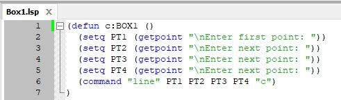

  3. Type "Box1" for the new name, and type the following lines of code:How To Draw Using LISP - The Black LISP -02- 4
    Based on what we have learned, these lines of code should make sense.

A new concept has been introduced in this code -- forcing text to appear on the next line. You may have noticed that with our OffsetCircles program, the prompts asking for user input were showing up successively, one after the other on the same line at the command prompt. With the prompt strings for the points in our new program, each prompt starts with a "control code" of "\n....". This forces BricsCAD to show the text on a new line or the next command prompt line.
Two things to keep in mind: it must be the backslash character and it must be a lower case "n".
This is an example of what is called "polite programming". The user comes to expect that the next thing to do is shown on the next line. This is the way nearly all BricsCAD commands "work", and as a programmer we should try to match the BricsCAD way of doing things.

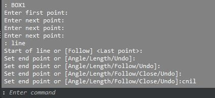

You may have noticed that when the new BOX1 command was executed everything that was performed within the line of code that included the (command) function was "echoed" to the Command line:
How To Draw Using LISP - The Black LISP -02- 5
This can be beneficial when writing new programs. If the program contains an error you can see exactly what line portion of the command, things may have gone awry. Once a program is running correctly, it is a common practice to turn this command echoing off.
You also may have noticed that after the last thing that our program did -- typing in a "c" to close the polygon we drew -- that "nil" was echoed to the screen. We must remember that every function we use "returns" a value. In the case of the expression (+ 1 1), the addition function returns the result of adding 1 and 1 together, and 2 is returned. The (command) function always returns "nil"... think of it as code for "done"... It is good programming technique to not allow that "nil" to be echoed to the Command line.
