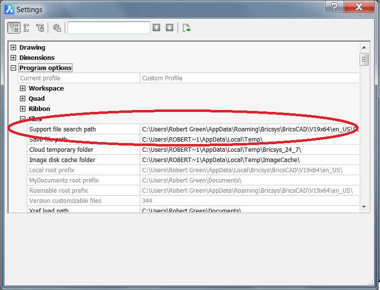

Be sure ON_START.LSP Exists
When BricsCAD starts up it automatically looks for an AutoLISP file called ON_START.LSP and executes any code it finds in the file, so you need to be sure it exists and that BricsCAD can find it. All you must do is place the ON_START.LSP file in BricsCAD’s support directory – you can manage this using the SETTINGS command and looking under Program Options / Files.
Settings-Dialog-Support-Path 2
Now simply exit BricsCAD and restart and the ON_START.LSP file will be loaded in and executed.
