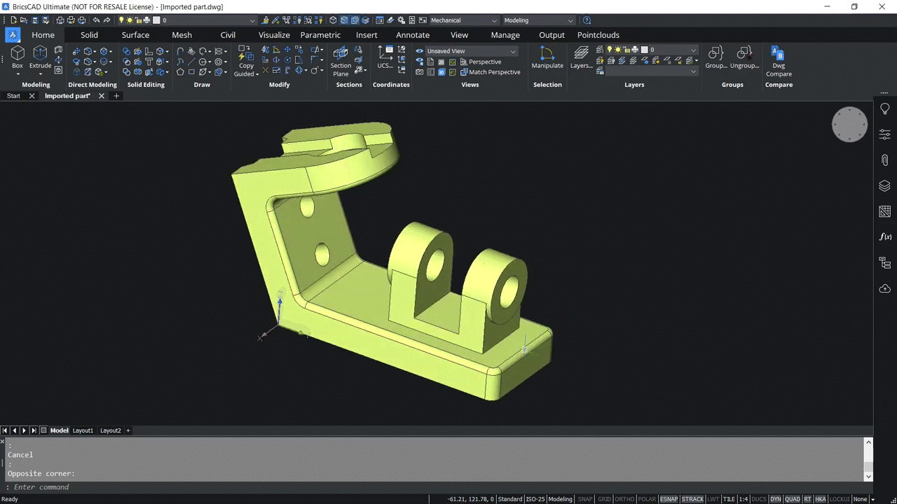

Automatic fillet recognition is already a feature in BricsCAD. In this part of the article, we will take a look at how that works with examples. In the example below, we have a 3D model in BricsCAD, and we select one of the fillets with the cursor.
How to use Automatic chamfer recognition in BricsCAD 0,17-0,20

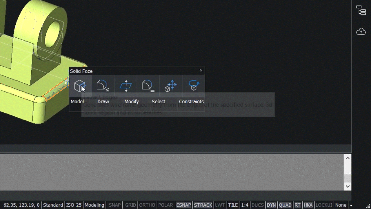

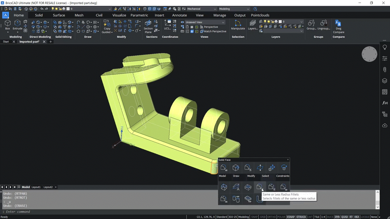

Now, let's get back to automatic chamfer recognition. In the example below, you can see The Quad in action.
How to use Automatic chamfer recognition in BricsCAD 0,21-0,24
Once The Quad is open in our example, we go to the Select option in its menu.
How to use Automatic chamfer recognition in BricsCAD 0,24-0,26

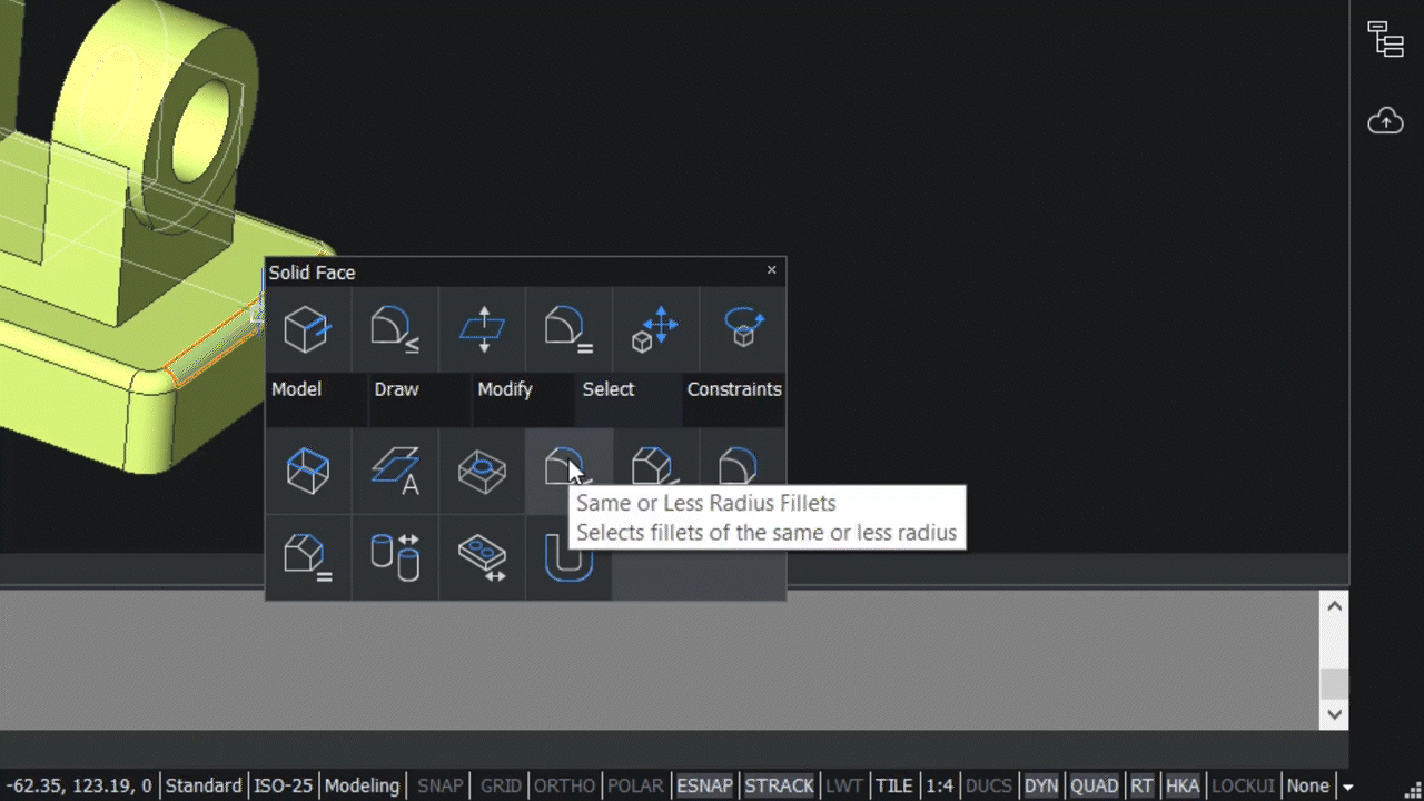

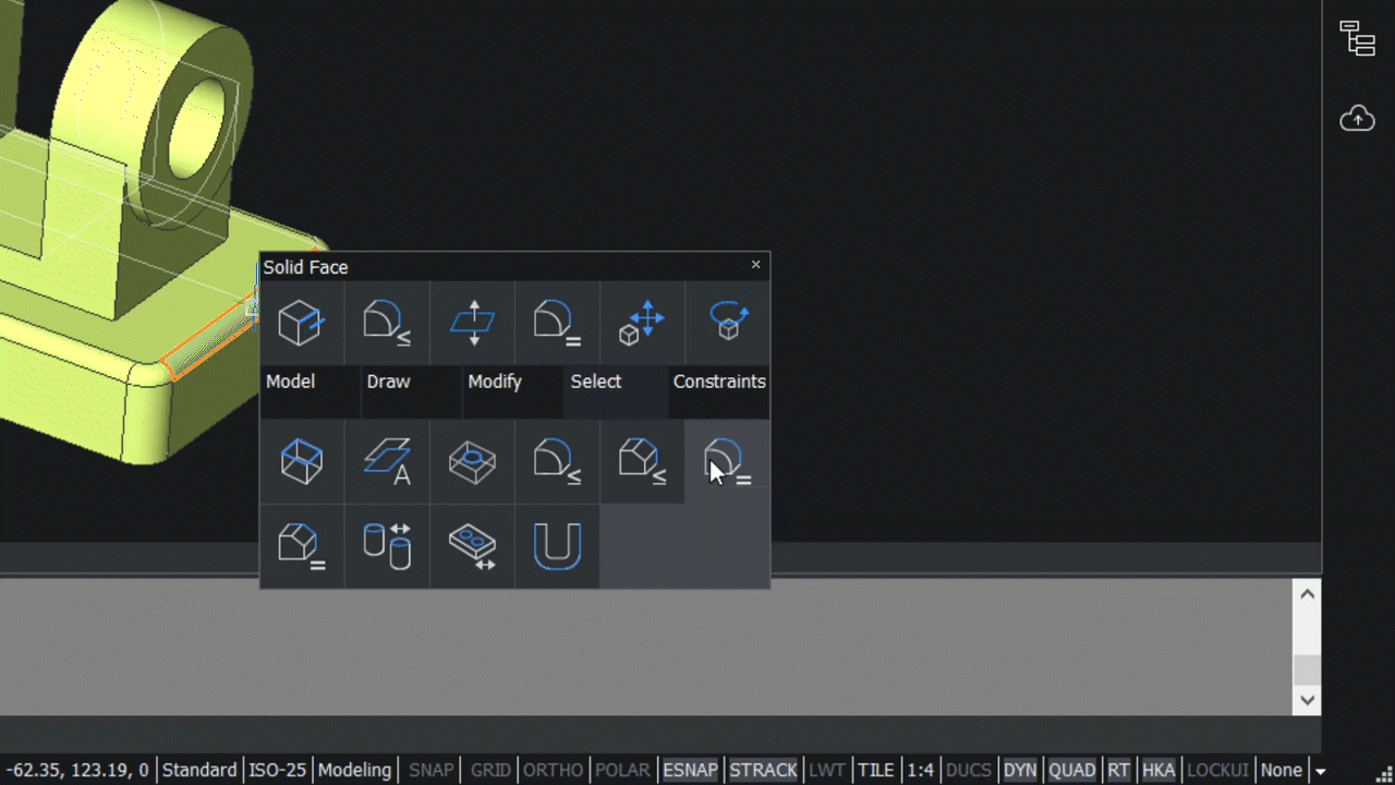

In the next example, you can see two options related to fillets. There is one that allows you to select fillets with the same radius and another that lets you select fillets with the same or less radius.
How to use Automatic chamfer recognition in BricsCAD 0,30-0,35
Below, we choose the same radius option, and you can see how BricsCAD finds the fillets that have the same radius and selects them.
How to use Automatic chamfer recognition in BricsCAD 0,36-0,44

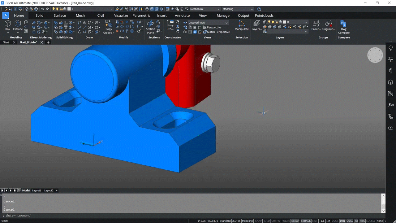

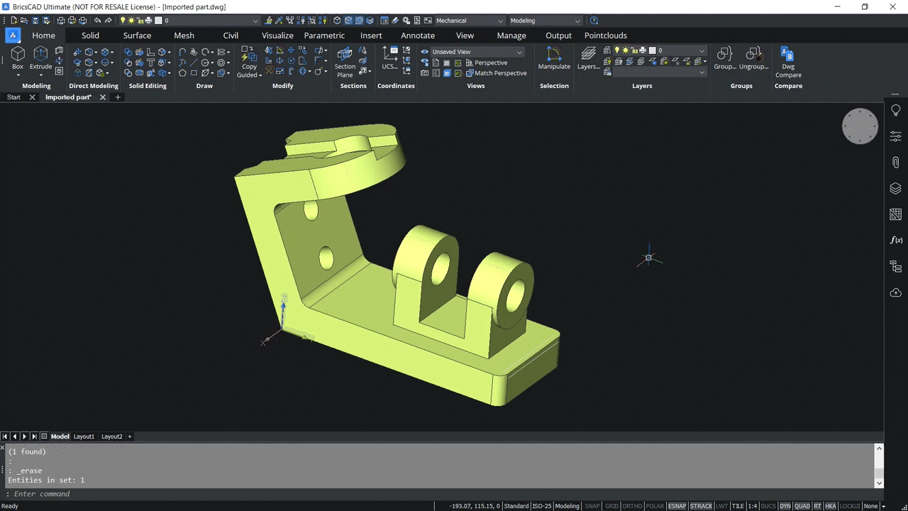

Once the fillets are selected, clicking the Delete button will delete them. You can see this in action in the image below.
How to use Automatic chamfer recognition in BricsCAD 0,45-0,49
It is just as simple to undo the delete operation. Below is the object we removed the fillets from, and we can use the undo button at the top of BricsCAD to add the fillets back.
How to use Automatic chamfer recognition in BricsCAD 0,50-0,53

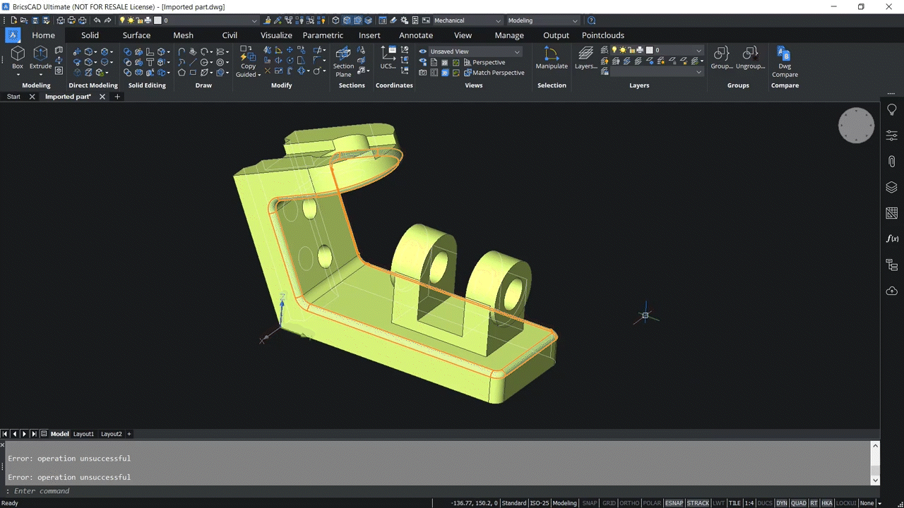

Next, we'll take a look at using the same or less radius fillets option. In the example below, we select another fillet and then use The Quad to use the same or less radius option.
How to use Automatic chamfer recognition in BricsCAD 0,55-1,00
Once you click the option, BricsCAD will select all the fillets that either match the selected fillet's radius or are smaller. In the image below, you can see that many more fillets were selected using the option.
How to use Automatic chamfer recognition in BricsCAD 1,01-1,03

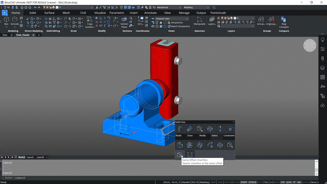

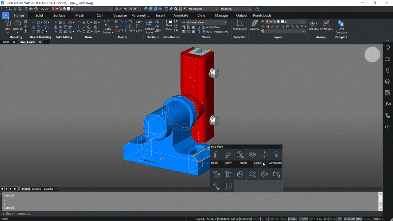

To do the same thing with chamfers that we did with fillets, again, we go to the Select option in The Quad. You can see this in action in the image below. This time, we choose the option that selects all the chamfers with the same offset.
How to use Automatic chamfer recognition in BricsCAD 1,20-1,23

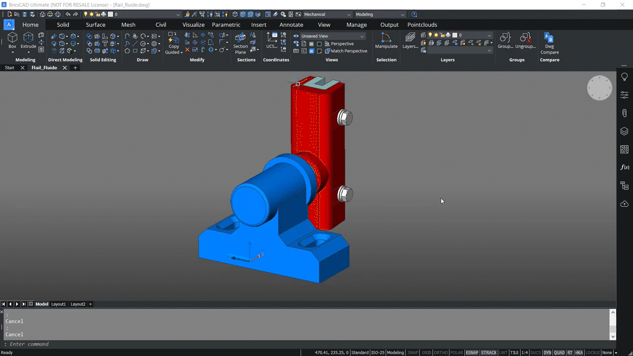

Once the button is clicked, BricsCAD selects those chamfers, just as expected. You can see this in the image below.
How to use Automatic chamfer recognition in BricsCAD 1,24-1,26
