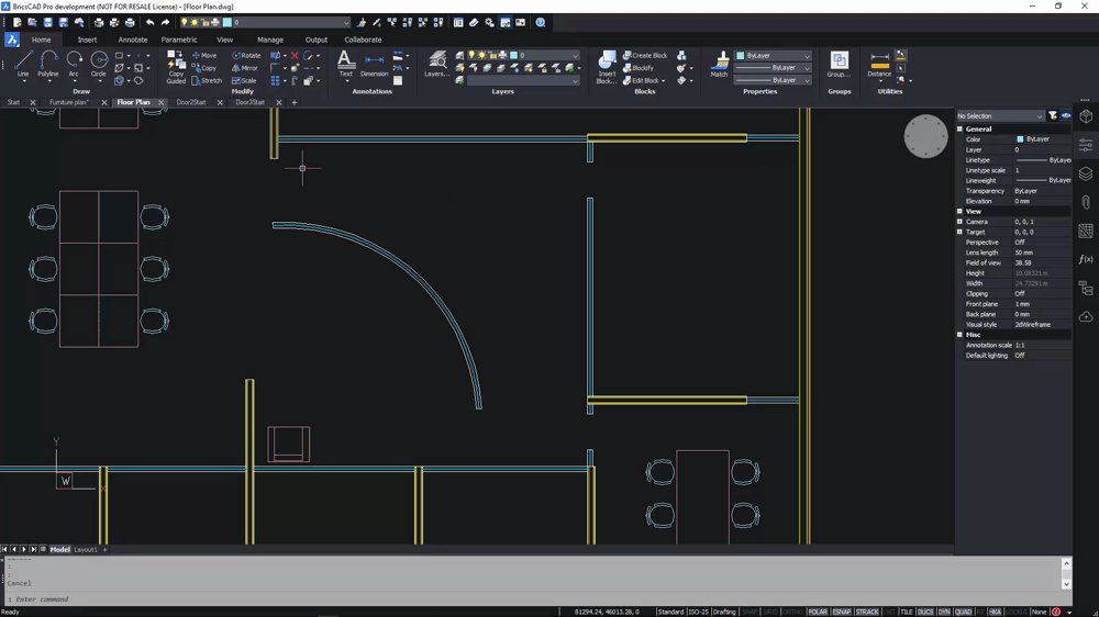

CopyGuided
3 BricsCAD Commands Everyone Should Know- copy guided 1
CopyGuided is a command that enables you to copy bits of a 2D drawing. BricsCAD automatically aligns the copied objects with existing drawing objects, it also automatically removes drawing objects. This saves you time lining objects up. For example, if you copy a door, it will create a hole in the wall and will line the door frame up with the wall. If you copy an electrical component, it will automatically line up the component on the wire and remove the section of wire where the component is present.
How to use CopyGuided:
  1. Clear the current selection.
  2. EnterĀ CopyGuidedĀ into the Command line.
  3. Draw a selection box around the entity that you wish to select. Anything completely withing the selection box (yellow) will be copied. Anything partly inside the selection box (blue) will be the guide curve or the reference curve. Hit Enter.
  4. Move the mouse to the location you wish to copy the object to. Click the mouse to place the object.
  5. (Optional) Repeat step 4 as many times as required.
  6. Hit Enter to exit the command.

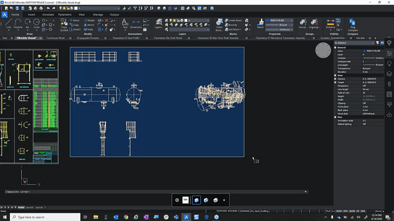

Blockify
3 BricsCAD Commands Everyone Should Know- blockify
Blockify is a command that can be used to automatically creat blocks in a drawing. It automatically detects identical sets of 2D and 3D objects in a drawing and replaces them by block references. It also blocks arranged in patterns with arrays. To do this the user can choose for BricsCAD to search the current drawing library or choose a selection manually to use as a reference.
How to use Blockify with manual selection:
  2. EnterĀ BlockifyĀ into the Command line.
  3. Select source entities and hit Enter.
  4. Click to select a block insertion point or hit Enter to accept the default.
  5. Hit Enter to search the entire drawing or ? for search area selection options.
  6. Enter a block name.
  7. BricsCAD will now search the drawing and automatically covert any repeated sets into blocks.
How to use Blockify with the current block library:
  3. EnterĀ BĀ into the Command line.
  4. Hit Enter to search the entire drawing or ? for search area selection options.
  5. BricsCAD will now search the drawing and automatically covert any repeated sets that match the current block library into blocks.
