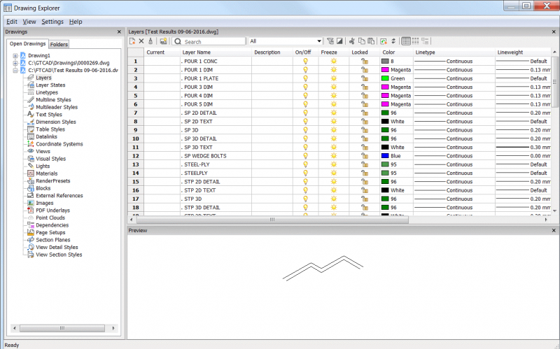

LAYER. AutoCAD® users expect the LAYER command to bring up a floating (modeless) palette that can be left open while working. In BricsCAD the default implementation of LAYER brings up the Drawing Explorer command set to the Layers tab (see Figure 1) but this is a modal that does not allow the user to keep working. Enter the BricsCAD LAYERSPANELOPEN command which looks just like an AutoCAD® user would expect (see Figure 2) – so our challenge is to substitute the LAYERSPANELOPEN command for the LAYER command and AutoCAD® users will again feel right at home.
1-DrawingExplorer-800x499Figure  1 – The EXPLORER command has several applications in BricsCAD – including layer management.
