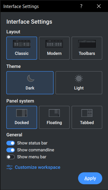

The Interface Settings dialog is new in BricsCAD Version 23. Designed to help you make BricsCAD your own. It makes simple customizations, such as changing the color theme or panel docking system, a sinch.
What is the Interface Settings dialog?
The Interface Settings dialog is new for V23. It gives you the option to switch between different workspaces: Toolbars, Classic and Modern (new for V23); the color theme; the panel docking system; and gives you controls for the Status Bar, Command line and Menu Bar visibility.

Where can I find the Interface Settings dialog?
At the top of each workspace, you’ll find the Access toolbar. At the end of the toolbar, you’ll see some blue letters: Interface Settings. Click this to open the dialog.
