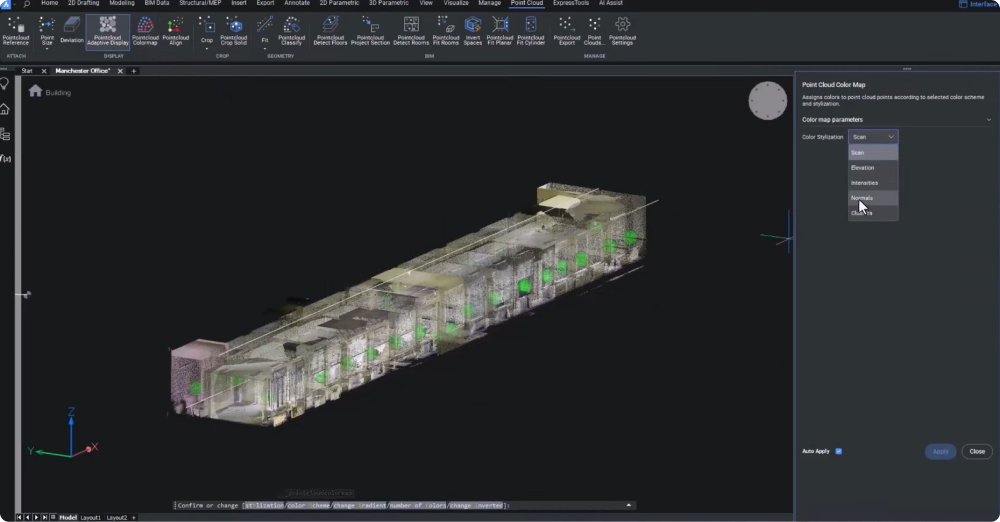

Calculate normals from structured point clouds
Lastly, we have implemented an HSPC point cloud normals feature. Now, you can calculate normals for structured point clouds already available in the cache in HSPC that do not have normal vectors yet.
HSPC BricsCAD
When the normals have been calculated, they will be added to the HSPC file.
  • Open the Pointcloud Colormap to view the results.
  • Under color stylization, select "Normals."
  • Now, the point colors change according to their XYZ plane alignment.
