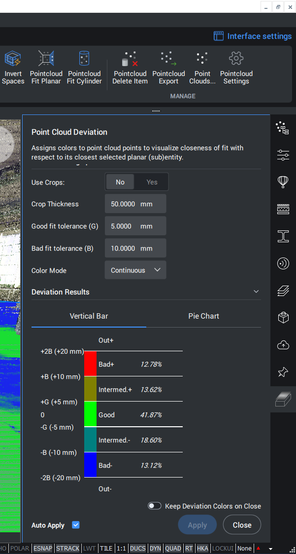

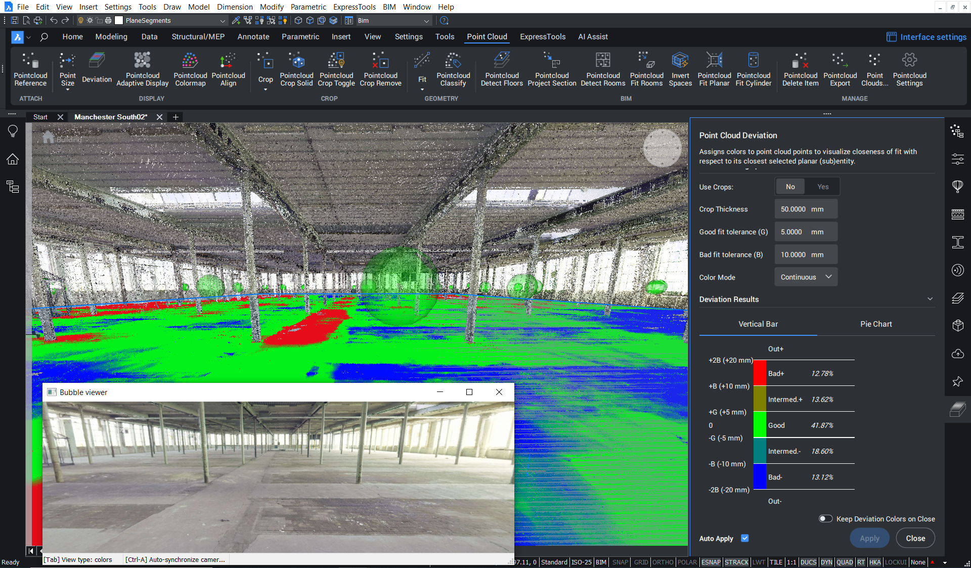

Once integrated into CAD software like BricsCAD, an ideal planar surface can be fitted to the point cloud data. This surface and point cloud can be used for precise surface deviation analysis of structures, including building structures made from RAAC.
By overlaying the point cloud data onto CAD models or reference designs, discrepancies in surface contours, dimensions, or alignments can be readily identified and quantified. This granular analysis enables engineers and architects to pinpoint areas of concern with unparalleled accuracy.
The early detection of surface deviations through point cloud-based analysis is paramount in mitigating potential structural issues in RAAC buildings. You can proactively address underlying structural weaknesses or material degradation by identifying deviations from the intended specifications early. This proactive approach can help minimize the risk of catastrophic failures.
