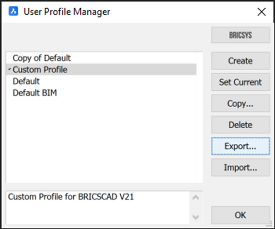

  1. In BricsCAD key in PROFILEMANAGER at the command line and click the CREATE button to create a new profile.

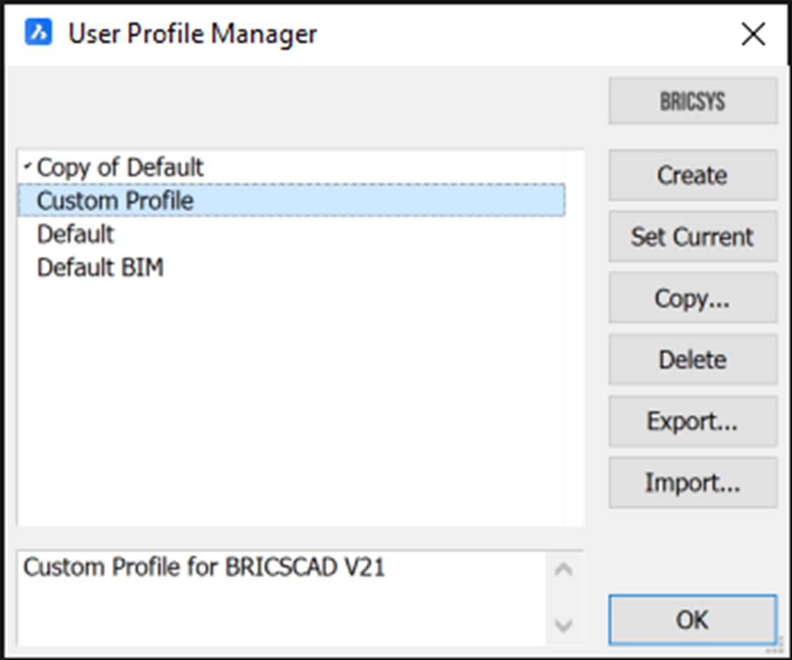

  2. Enter the name and notes for the profile and click the OK button.
    2-CreateProfile

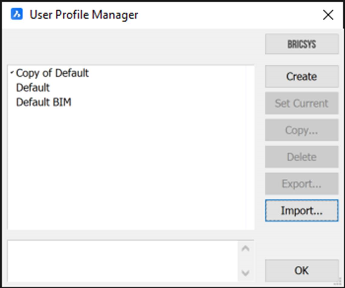

  3. Set the new profile to current and test for proper operation of the system.
    3-SetProfile
  4. Assuming everything is working properly, key in PROFILEMANAGER at the command line again then click the EXPORT button.

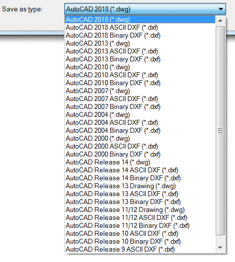

  5. Save the profile to a network location that will be available to all machines you’ll wish to setup later. (Note: I like to use the installation files directory where I keep installer files and batch procedures for consistency.)
    5-ExportFormats
