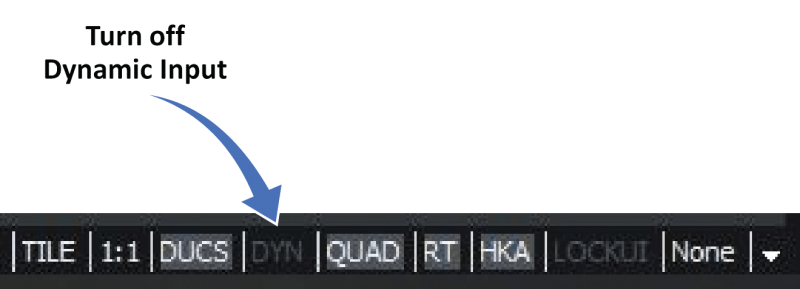

Before practicing the use of functions at the command prompt, it is advantageous to turn off the Dynamic Input setting. Toggle it off (turn it dark) using the status bar in BricsCAD:
What Is LISP- 1-5-e1595839858721-800x289

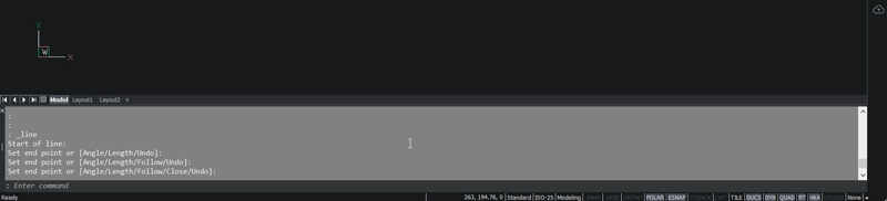

Also -- it is a good idea to make your command prompt area show a few lines "taller" than usual -- maybe 8 or 10 lines. To do his hover you mouse over the top of the Command line edge until a double arrow appears and click and drag to change the height of the Command line:
What Is LISP- 2-1

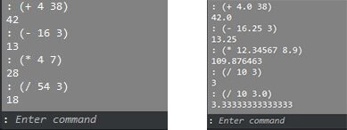

Examples of math functions entered into the Command line:
What Is LISP- 3.5
