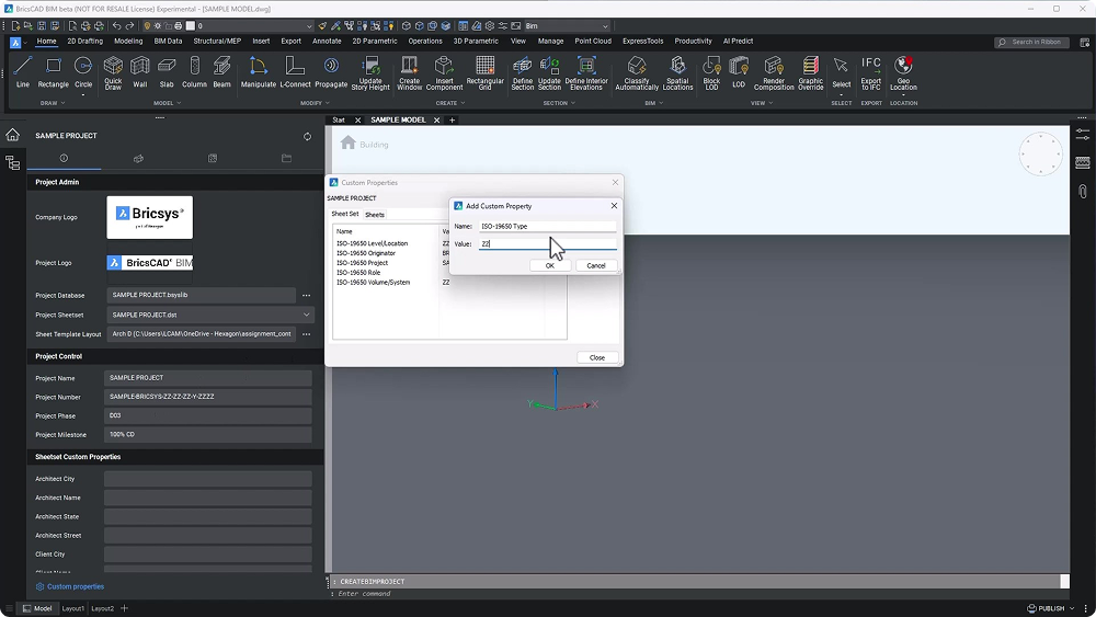

Project details BIM Browser BricsCAD BIM
To help with this, BricsCAD BIM has simplified the project setup for BIM collaboration. You can input relevant project details via the BIM project browser and customize the fields to suit your team's and the project's specific requirements. This browser also displays the various named views, numbered sheets, and any relevant files stored within your project's directory.

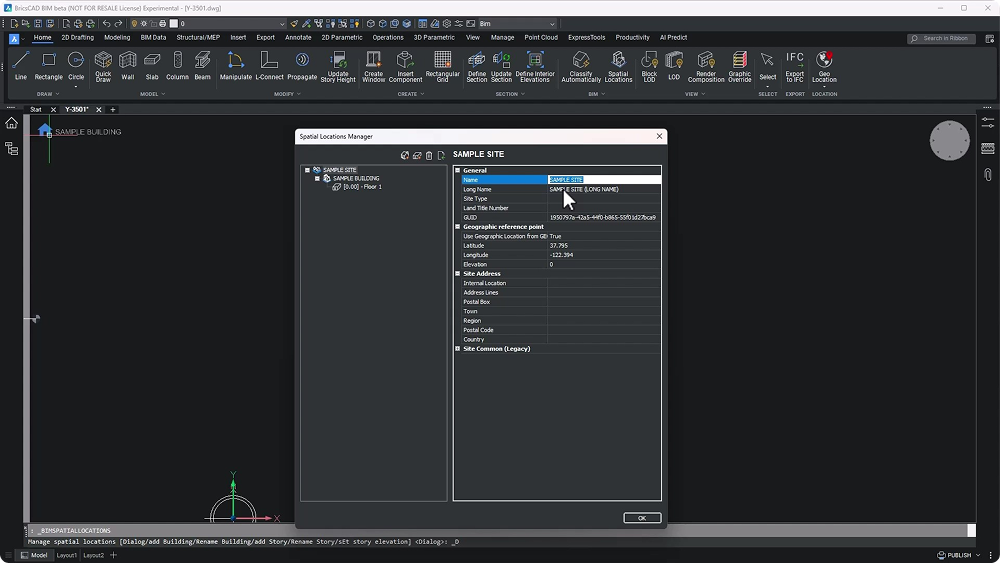

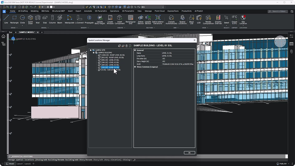

Spatial locations manager BricsCAD BIM
New to BricsCAD BIM V25.2, the project's name is not indicated upon export, and once you export the file will receive the IFC class definition and IFC project. Similarly, when you use the spatial locations manager, the project site is also named to comply with the project's standards. Select the site at the top of the hierarchy and provide a name. In V25.2, the site name is now exported as the IFC class IFCSITE. It will be available for query downstream and during data validation by the project's information managers.

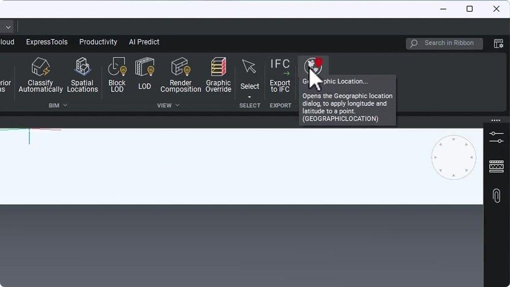

When you need to get your shop drawings approved and are also expected to align your 3D models with BIM assets, this can be a huge risk. So, in BricsCAD BIM V25.1, we introduced the first phase of our georeferencing capability for IFC4 Workflows and advanced this capability to ensure that the details modeled in BricsCAD BIM are positioned precisely in place for export into a federated model downstream.
geolocation button BricsCAD BIM
  • Select the Geolocation button from the home screen, or type GEOGRAPHICLOCATION into the command line.

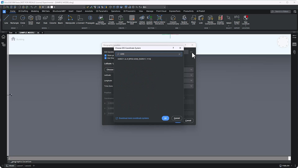

GIS coordinate BricsCAD BIM
  • Click the ellipses button and select the project-appropriate coordinate system.

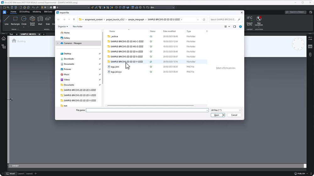

import IFC BricsCAD BIM
  • Next, at import, select the IFC your design team provided.

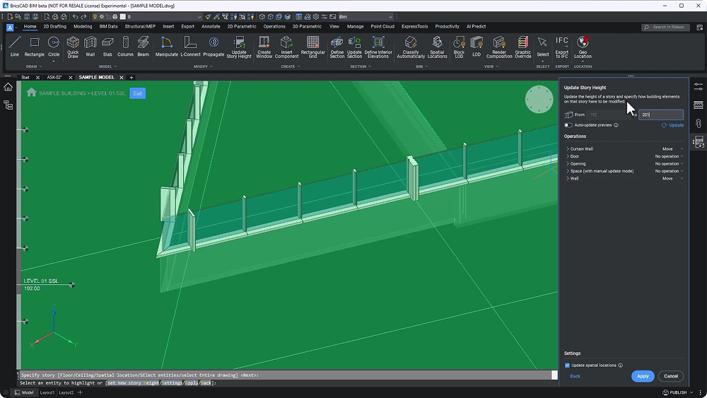

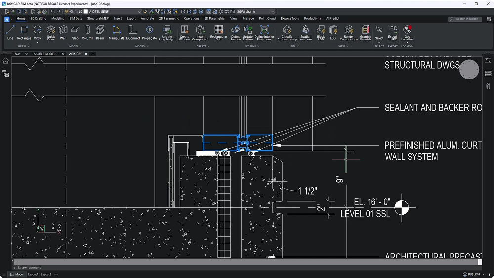

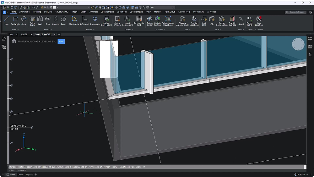

We've added a new tool to help you get up to speed with a project after a design has been coordinated - in only minutes. In this example, the bottom joint of the curtain wall system is modeled to the level SSL elevation of 16 feet above grade. Say you receive a sketch detail from the design team - you'll need to revise the joint to accommodate the slab edge.
raise transom 9 in
The bottom transom of this curtain wall will need to be raised 9 inches without impacting the curtain wall on other levels.

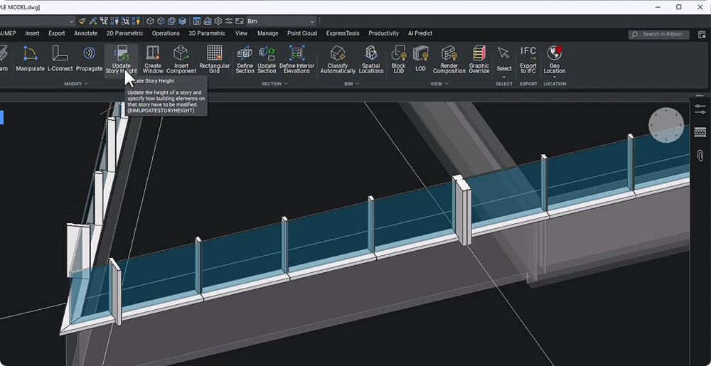

BIMUPDATESTORYHEIGHT button BricsCAD BIM

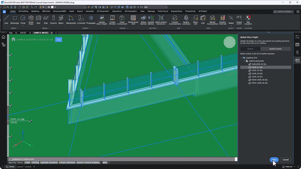

You can do this easily in BricsCAD BIM V25.2 with BIMUPDATESTORYHEIGHT. This feature gives you parametric control over level height adjustments.
select story level adjust BricsCAD BIM
  • First, select the level that needs to be adjusted. Only the curtain wall systems must be affected by this change, and all other components at this level must be left unchanged.
change curtain wall BricsCAD BIM
  • From the panel, in the Curtain Wall and Wall dropdowns, select Move, add the new height in the "to" box, and click Apply.

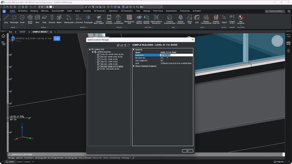

spatial locations manager rename
When you return to the spatial locations manager, you will see that the level no longer represents a structural slab level. We have renamed it to reflect that this level now represents the top of the slab edge.

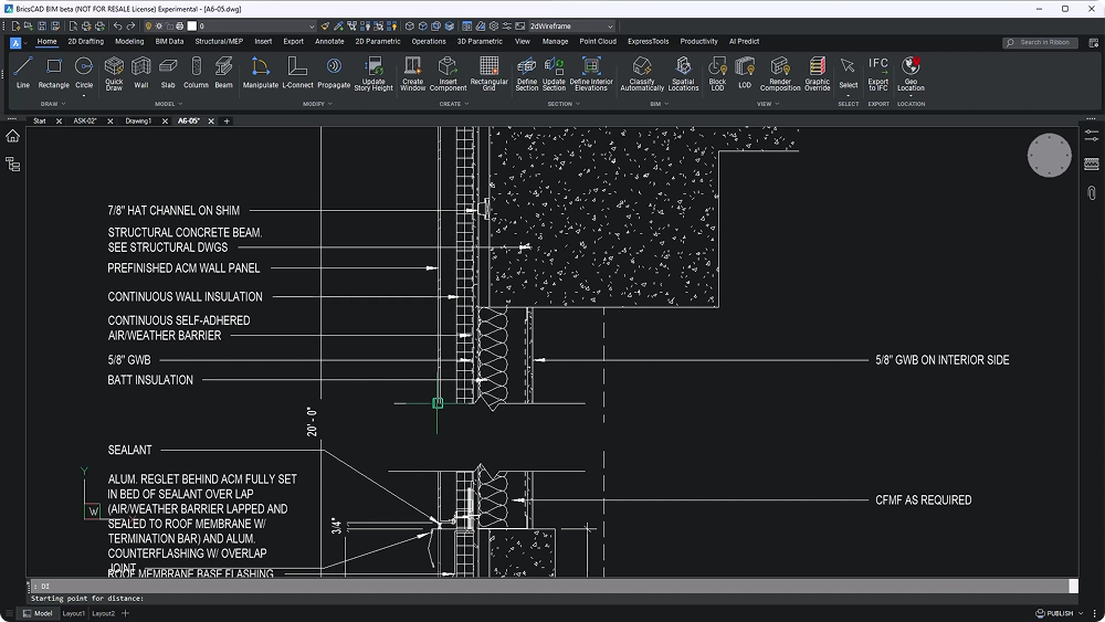

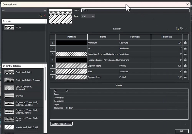

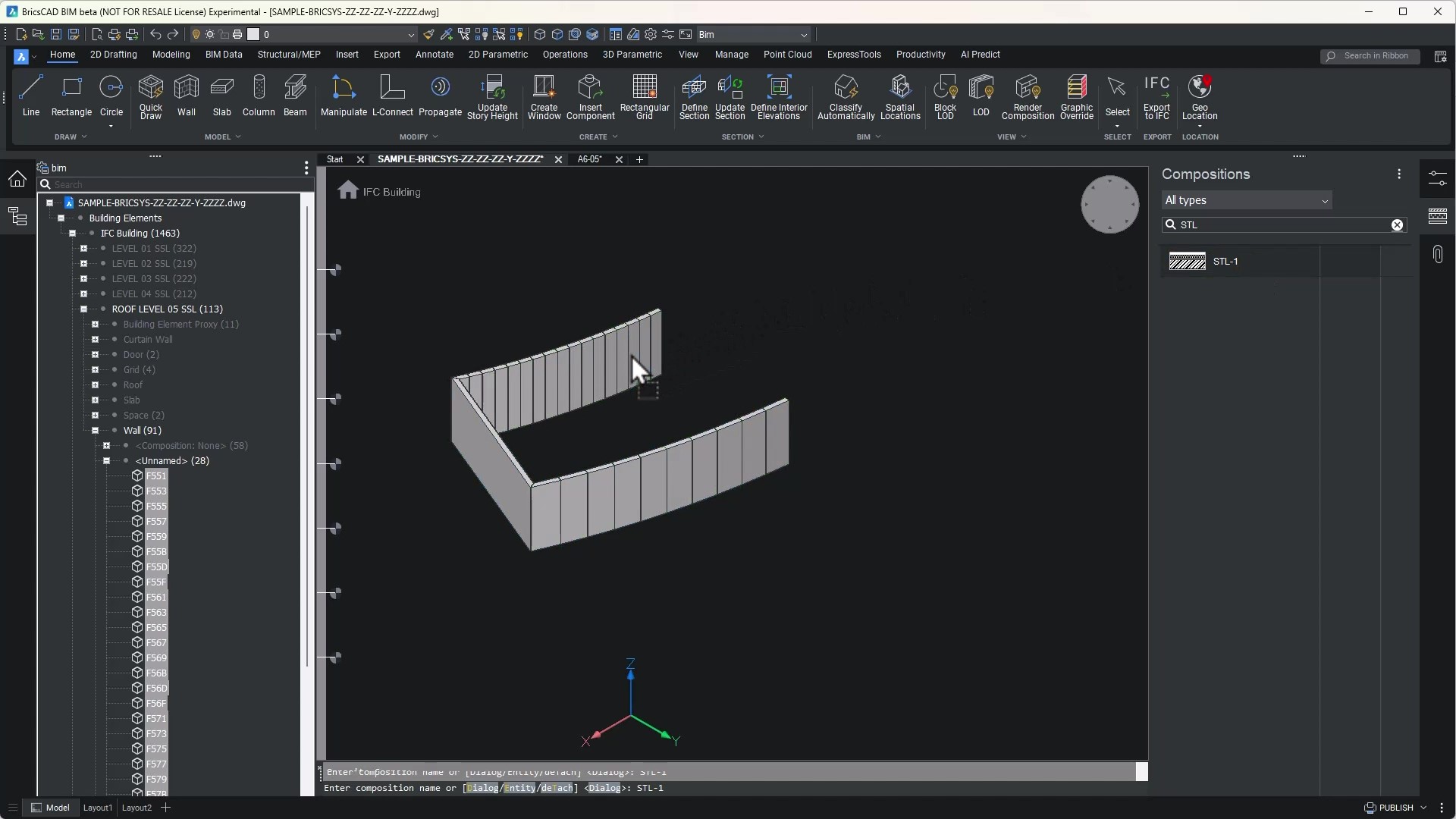

Before preparing for export, let's take a look at one more update in V25.2. Here, we've gone to the project's roof level. Let's say you received some details from the design team and need to model the wall compositions accordingly. This wall has a thickness of 11.5 inches.
compositions panel BricsCAD BIM
compositions dialog box BricsCAD BIM
Use the BIM Compositions panel and the compositions dialog box to build up the compositions as specified in the construction detail.
BIMATTACHCOMPOSITION Command
Use the BIMATTACHCOMPOSITION command to assign these multiple plies to already modeled walls.

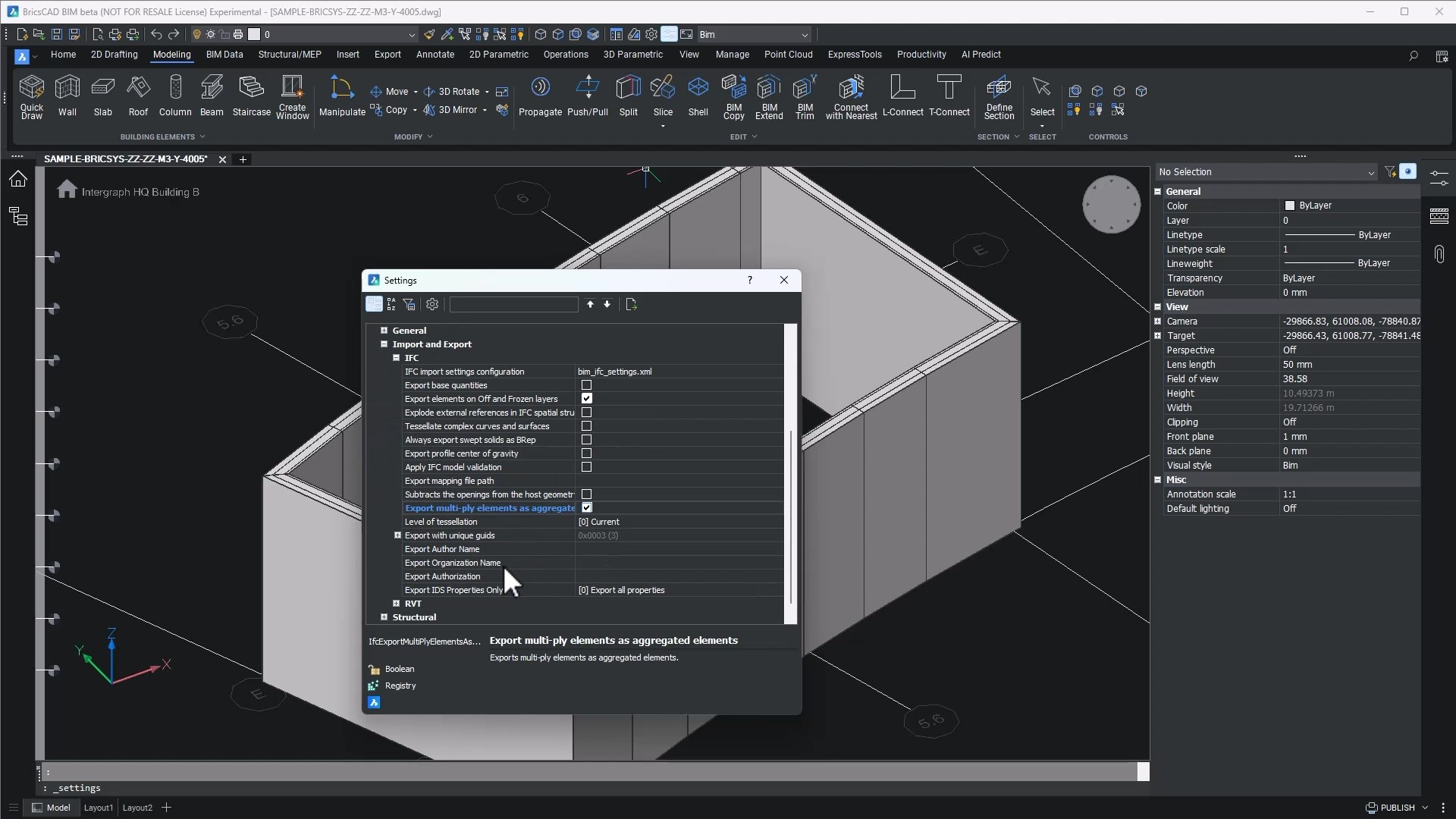

Improved Fidelity for Data Validation
Export multi-ply elements as aggregated elements
When you're back in BricsCAD BIM, navigate to Settings > BIM > Import and Export > IFC. From here, check the Export multi-ply elements as aggregated elements box.

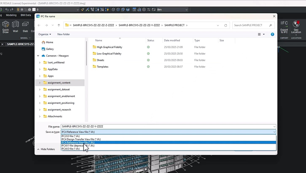

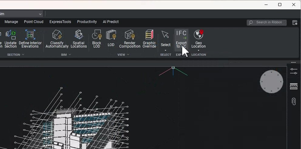

IFC Export button
IFC Export
Now, you are ready to export for federation and validation. Select the Export to IFC button from the Home tab, select Entire model when prompted, and choose IFC4 Reference View from the dropdown.

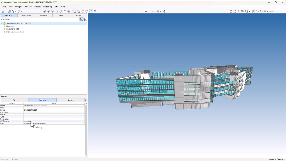

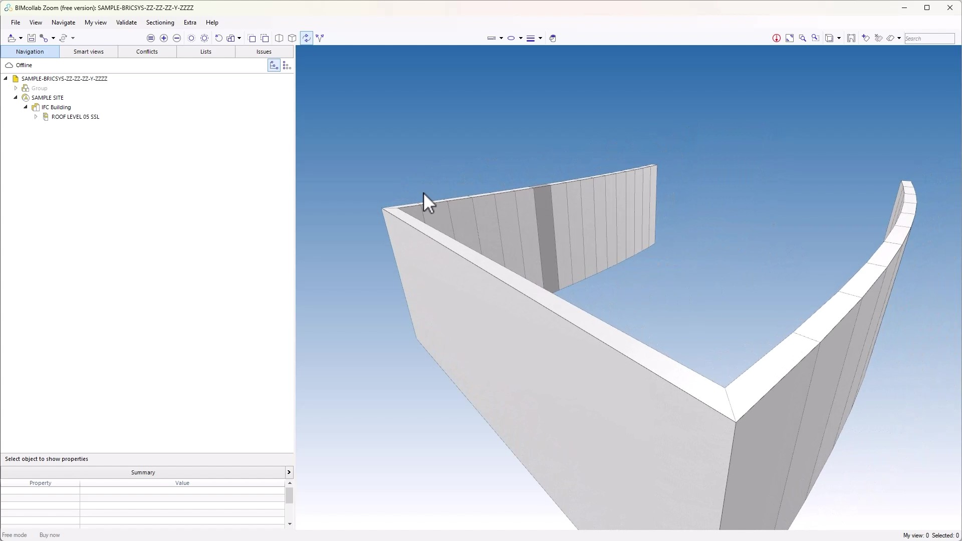

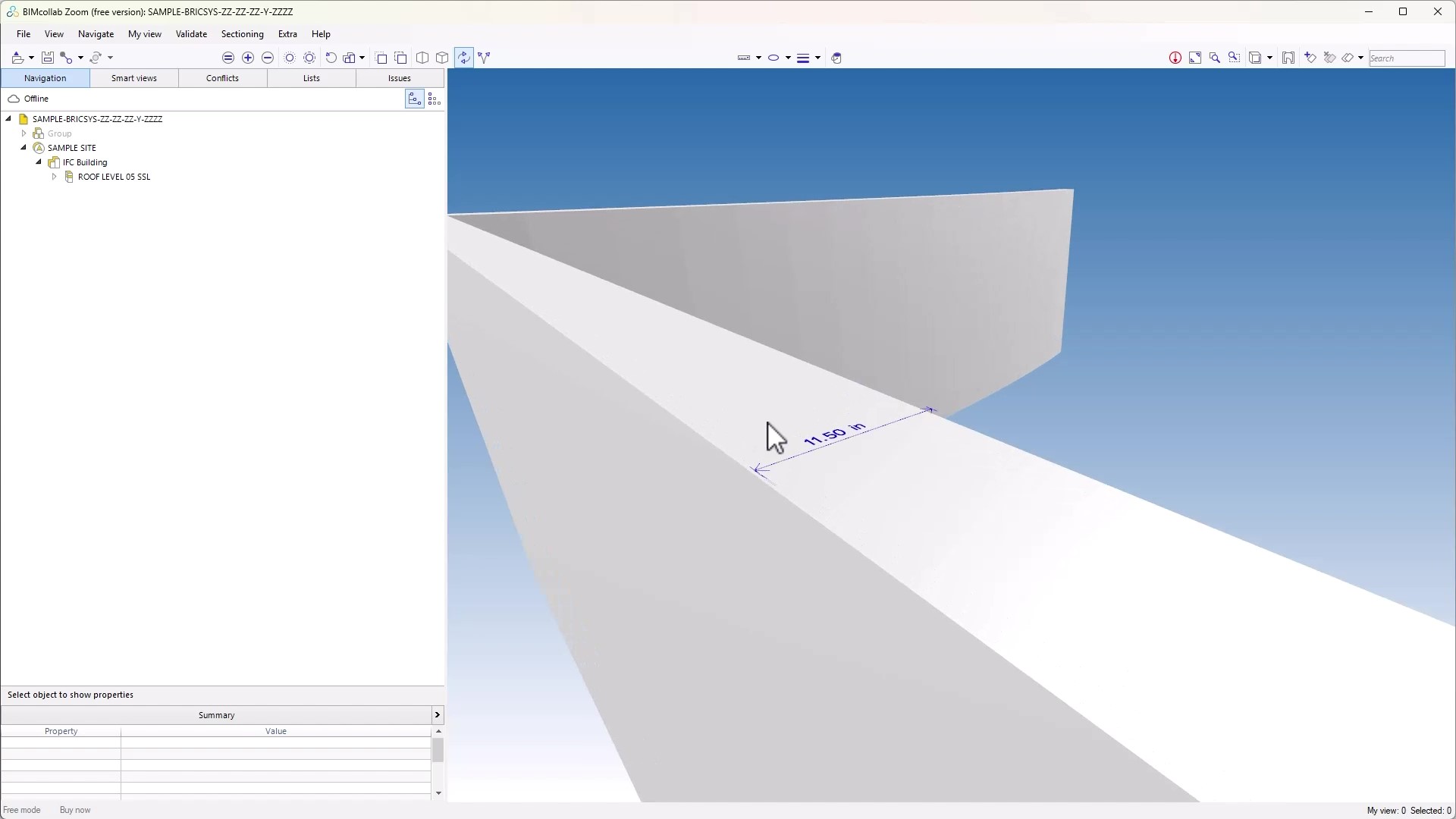

final asset BricsCAD BIM IFC Asset
You can then view the delivered asset inside a model checker and see that the interface with the slab edge was adjusted. Then, you'll see that both your IFC project and IFC site classes are defined.
