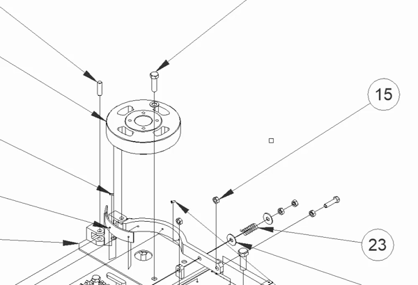

Isometric
Is it better to create an isometric drawing from 2D plans or to build a 3D model and 2D isometric drawings? Unfortunately, there is no "one size fits all" solution.
If only a single drawing from a single angle is required, directly creating the drawing in isometric is probably the fastest solution. However, many drawings from different angles need to be created. In that case, frequent drawing changes are likely, or the 3D model could offer additional value to the project later; then, making a complete, 3D - 2D isometric drawing is the way to go.
In reality, the solution is likely a compromise between the two. You might choo a 3D model of the main parts and draw flexible items, such as cables and springs, in 2D afterward.
2D vs 3D CAD- stretch 2
*Editing a 2D isometric drawing in BricsCAD with the stretch command. *

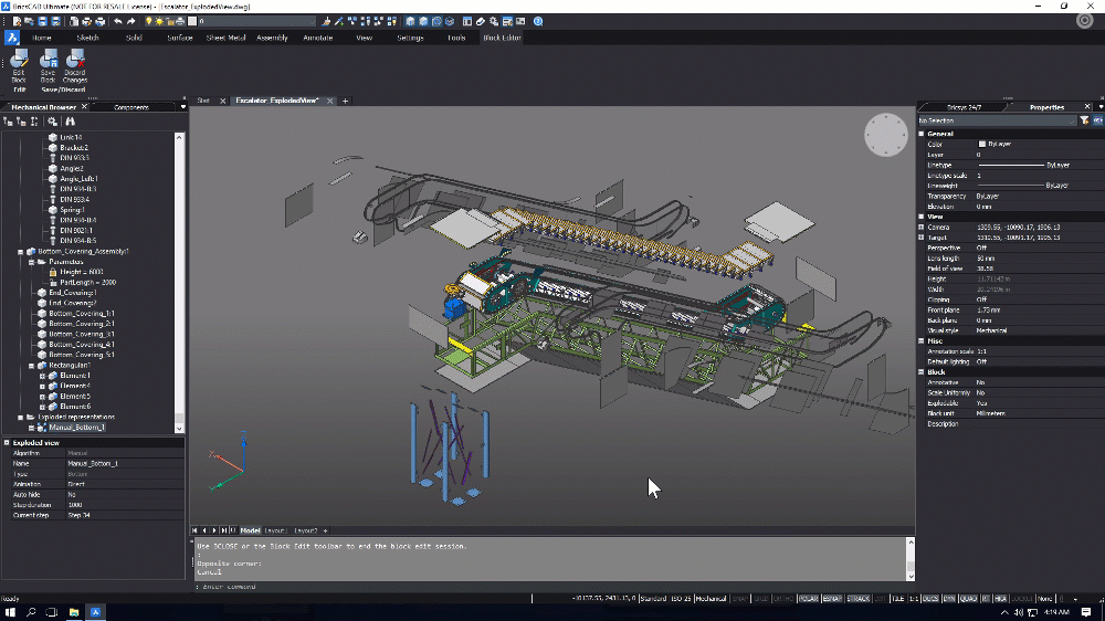

Remember, you don't always need to model every nut and bolt. Sometimes a simplified 3D model is enough; only model what you need!
2D vs 3D CAD- DesignAirsSpace-3D-Mouse-3
*3D models can be a great way to show complex assemblies. *
