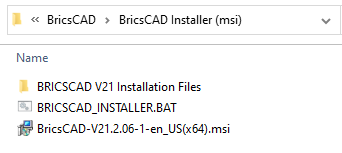

  1. Use an editing program to create the batch file and be sure to save it in the folder where the BricsCAD-V21.2.06-1-en_US(x64).msi file resides
    BRICSCAD_INSTALLER.BAT
    O:\BricsCAD v21 Installation Files

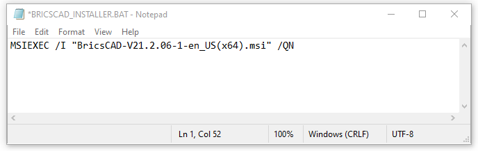

  2. Add this syntax to the BAT file:
    MSIEXEC /I "BricsCAD-V21.2.06-1-en_US(x64).msi" /QN

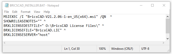

Now we can save the BAT file and test it. The line of code in the BAT file can be lengthy and could look like this:
MSIEXEC /I "BricsCAD-V21.2.06-1-en_US(x64).msi" /QN SHOWRELEASENOTES="" BRXLICENSEDESTFILE=" O:\BricsCAD License Files" BRXLICENSEFILE=" BricsCAD.LIC " BRXLICENSESERVER="host"
This long line of code can be very hard to manipulate in a text editor so you may wish to format your BAT file using the “^” function to continue input over several lines of input like this:
MSIEXEC /I "BricsCAD-V21.2.06-1-en_US(x64).msi" /QN SHOWRELEASENOTES="" ^
BRXLICENSEDESTFILE=" O:\BricsCAD License Files" BRXLICENSEFILE="BricsCAD.LIC" ^
Or even
BRXLICENSEDESTFILE=" O:\BricsCAD License Files" ^
Just be sure that a space and the ^ character are at the end of each line you wish to continue to the next line of input.
