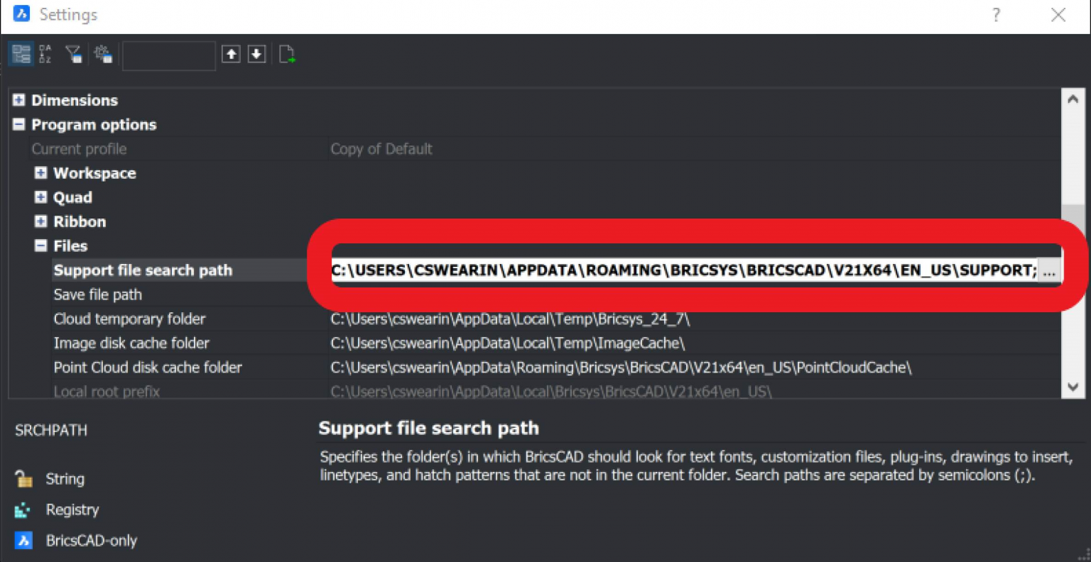

Network: Take Inventory of Paths/Shares
BricsCAD, like any CAD program, is constantly accessing a variety of files to do its job and it is likely that most of those files are coming from a network location. Whether the locations are UNC paths or shared drive letters, your current CAD program is already configured to point to the right places, and getting BricsCAD configured will be essentially the same.
Action item: Take inventory of all UNC paths, shared drive letters, and folders BricsCAD will need to access, so that configuration will go smoothly when the time comes.
2-Settings-1536x792
Network file paths will replace C drive paths in BricsCAD’s SETTINGS command.

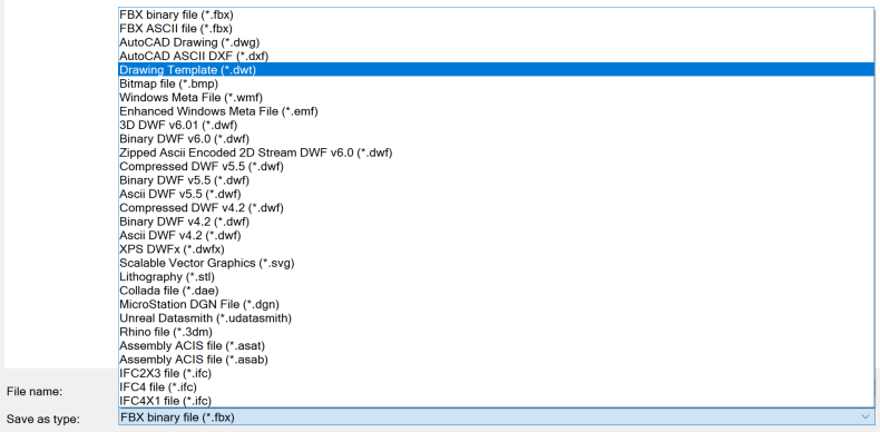

As project work is done, it is a given that outputs like prints, plots, and PDF files will need to be created. BricsCAD can support virtually any print device you’re using with your current CAD system, so printing and plotting is not an issue. BricsCAD includes its own PDF generating driver but can also support other commercial PDF writers from companies like Adobe or Bluebeam.
3-SaveAsFileType
Action items: No action item needed. Just to be sure you can always download the free 30–day BricsCAD trial version and test your printers, plotters, and drivers.

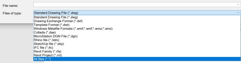

4-OpenFileType

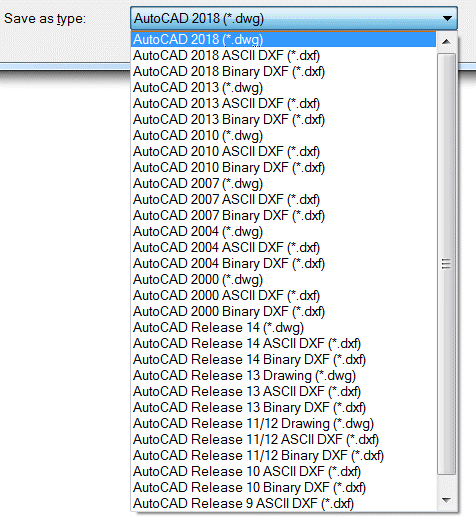

Model Files: Know Your Formats
Of course, all the work users do means nothing if they can’t save it to the desired format. Since BricsCAD supports all versions of .dwg from 2018 back to 2000, you should be fine if .dwg is your deliverable format. But CAD data isn’t just about .dwg so BricsCAD’s ability to open and save to other file formats like .dgn, and BIM standard .ifc mean that BricsCAD can fit into workflows that you wouldn’t normally associate with being .dwg centric.
5-ExportFormats
Action items: No action items are needed since BricsCAD supports major industry formats directly, but knowing what output formats you need to provide to your clients and what sorts of data you’ll need to import is always a good idea.
