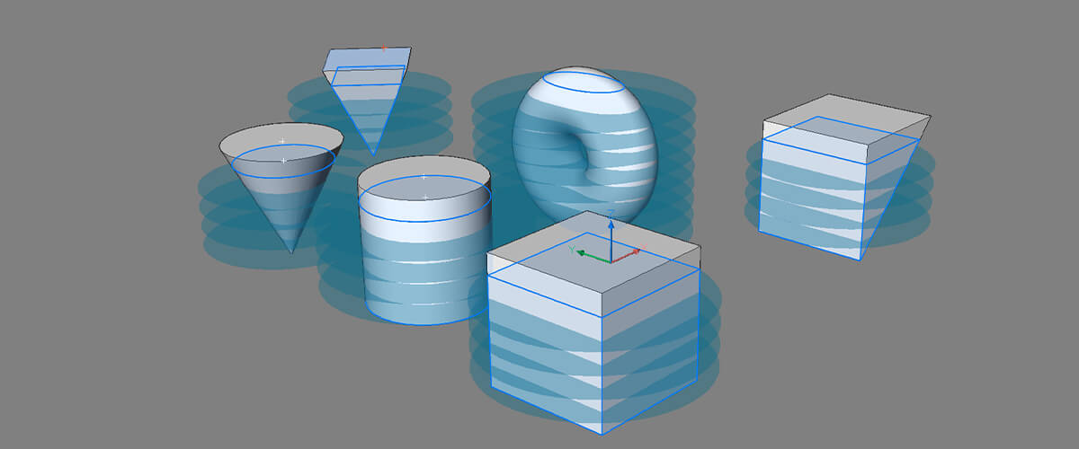

Multi-Slice does exactly what it says on the tin: it takes the SLICE command up a notch, allowing you to divide a solid into multiple pieces.
Multi-Slice- breadslice 2-1024x515
"It's pretty straight forward" -- she tells me humbly. Which is exactly why it's one of my favorite tools in BricsCAD! Nothing complicated, no steep learning curve, just execute the command and you're good to go.
What she fails to mention, however, is just how versatile this tool really is. Want to create a balcony? No problem. What about slicing up an unusually shaped building into floors? Easy! Want to split up cupboards? Simple! Once you start using Multi-Slice, you'll want to divide everything up.
Multi-Slice- slice slice
You can use it to divide objects at an equal distance with the 'Repeat' option or select the distances individually. You can even mix and match during a single execution of the command.
Another cool feature of Multi-Slice is that it automatically splits solids, unlike commands such as Subtract or Extrude. No need to use the SolidEdit -- Solid -- Separate command.
Multi-Multi-Slice
Did you know you can use Multi-Slice on multiple objects too? Simultaneously slice multiple objects along the same plane.
