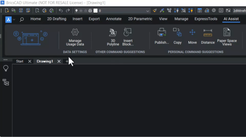

In BricsCAD® V23, the AI Assist Ribbon Panel suggests the commands you will likely need next based on your workflow patterns. The ribbon learns as you use BricsCAD, and it will give you suggestions based on how you and users like you use BricsCAD – saving you time searching for the command you need next!
How to access the AI Assist Ribbon Panel in BricsCAD®
The AI assist Ribbon panel has two states – an empty state and a populated state. When the ribbon panel is populated, it will include personalized command suggestions.
BricsCAD AI Assist Ribbon Panel

Once you've been using BricsCAD for a while, after you sign up for the BricsCAD Usage Data Program, BricsCAD populates the AI Assist Ribbon Panel with personalized comments and suggestions.
Other command suggestions are command suggestions from BricsCAD.
Personal command suggestions are your frequently used commands made easily accessible
